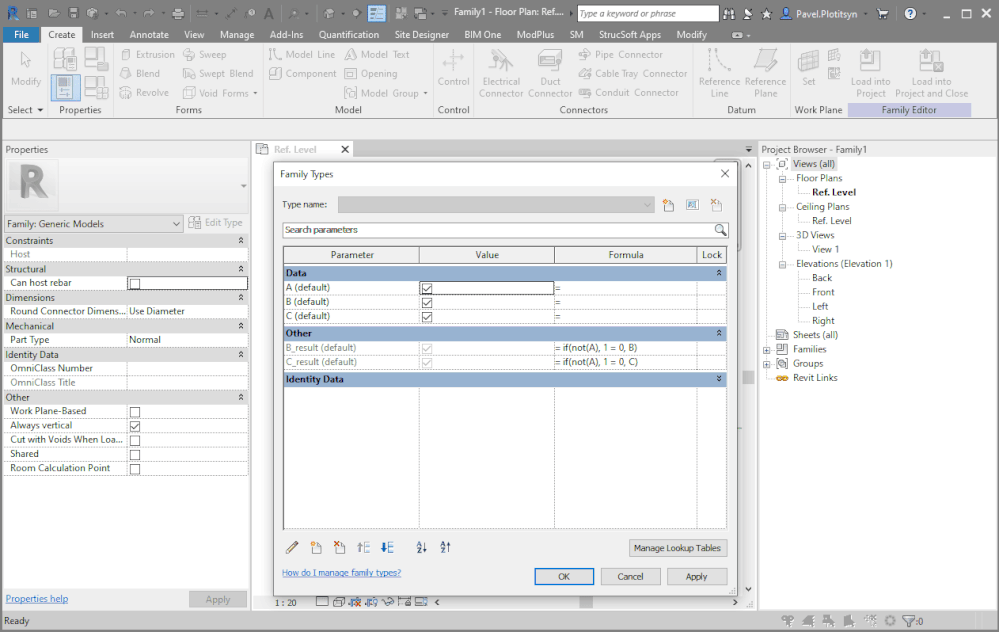

Hi. Do you want to add conditions using API? If not, then such questions should be posted here.
As for your question, you can add additional parameters (result), as in the .gif below.
Привет.Хотите добавить условия с помощью API?Если нет, то такие вопросы нужно размещатьздесь.
Что касается вашего вопроса, вы можете добавить дополнительные параметры (результат), как на .gif ниже.

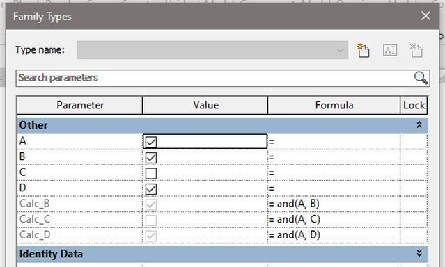

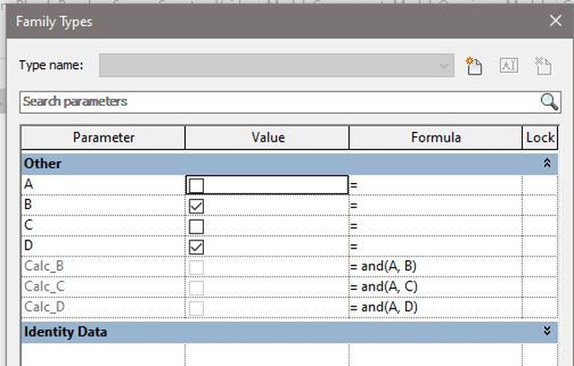

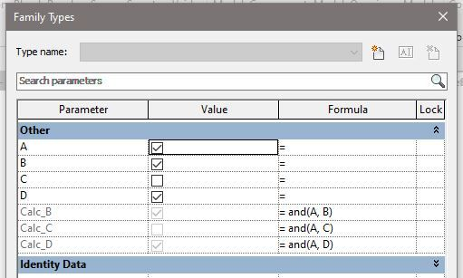

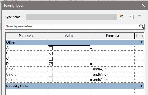

Hi,
As shows below you will need additional "calculation parameters" to perform this.
But the formula can be simplefied.
A, B, C and D are the input Yes/No parameters.
A = Main (so if Off, B, C, D should also be off)
Calc_B = And(A, B)
Calc_C = And(A, C)
Calc_D = And(A, D)
So only if A and B are true, true is returned, otherwise it's always False (if both false, also false is returned)
